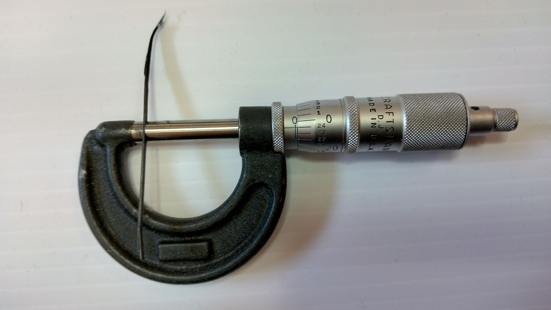

I purchased it in 05-2024 from the original owner (Bob) who purchased it in 2020 from the owner of a high end guitar shop in Denver. The shop owner used it as his personal guitar for a year then sold/shipped it to Bob in Texas where it remained and was thereafter well cared for. At some point (the shop owner) allowed it to dry out enough for the top to sink, lowering the string height. Someone (presumably his Luthier) bonded a .025" ebony shim to the bottom of the saddle to raise the string height. It was shipped to Bob with the shim in place and when it returned to a 45-55% humidity environment where Bob keeps his guitars the top raised back up. Bob reports the guitar has always used 11-52 strings.

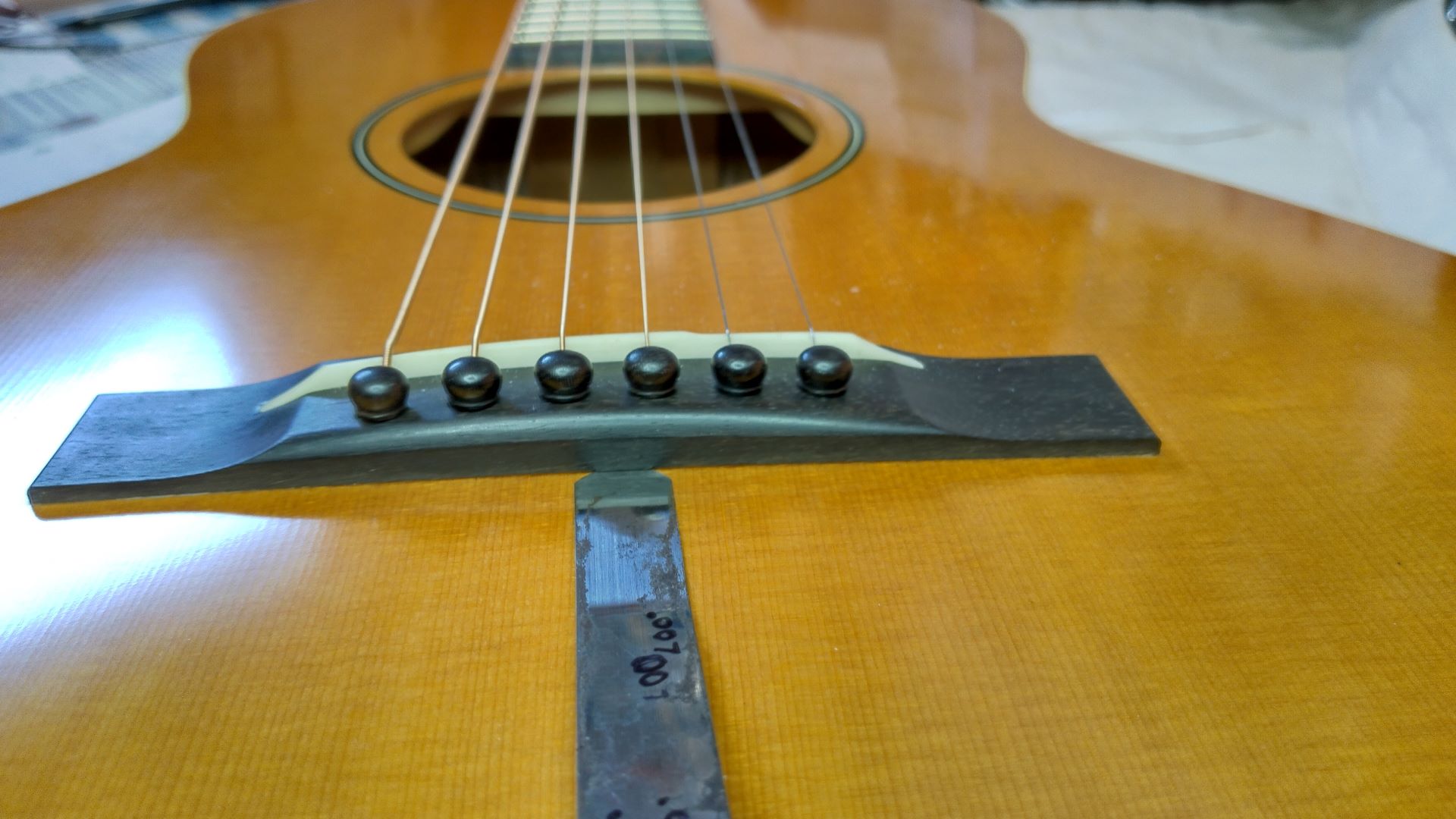

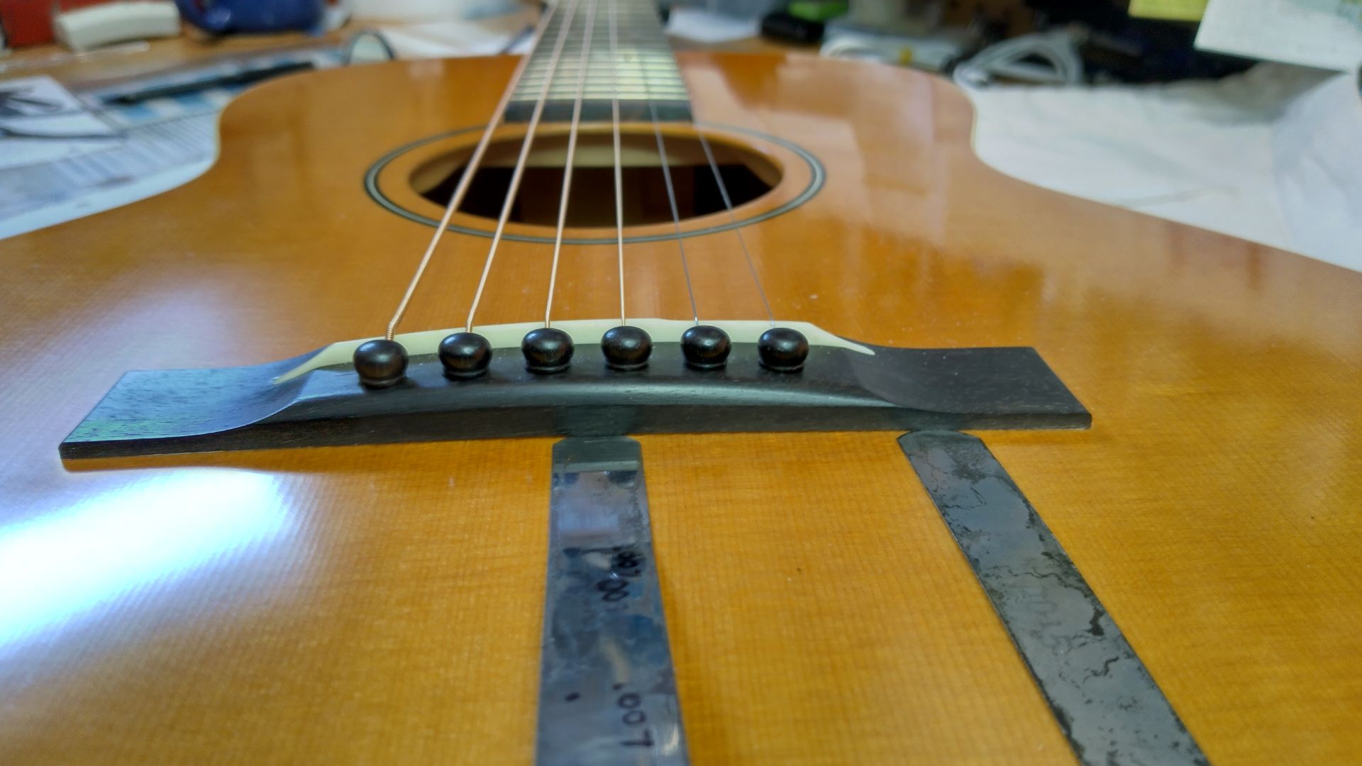

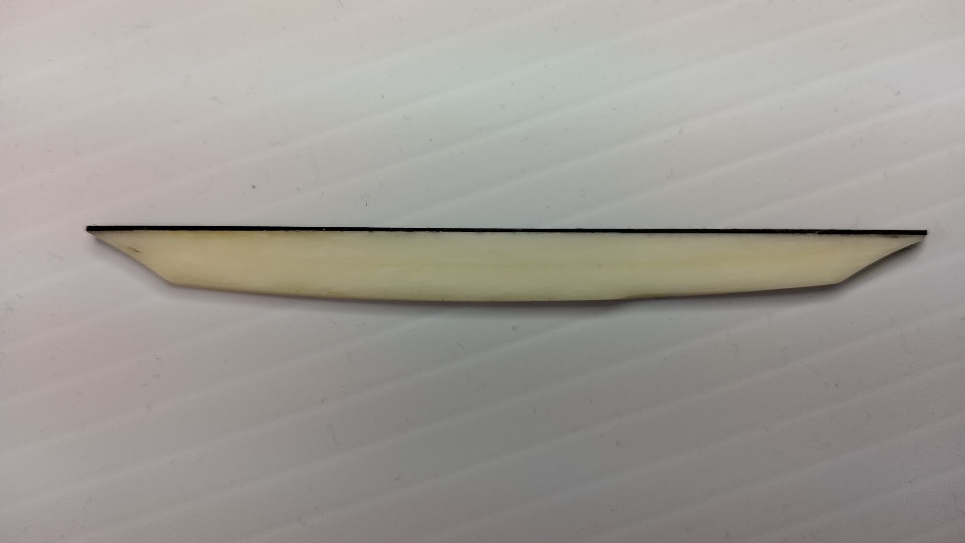

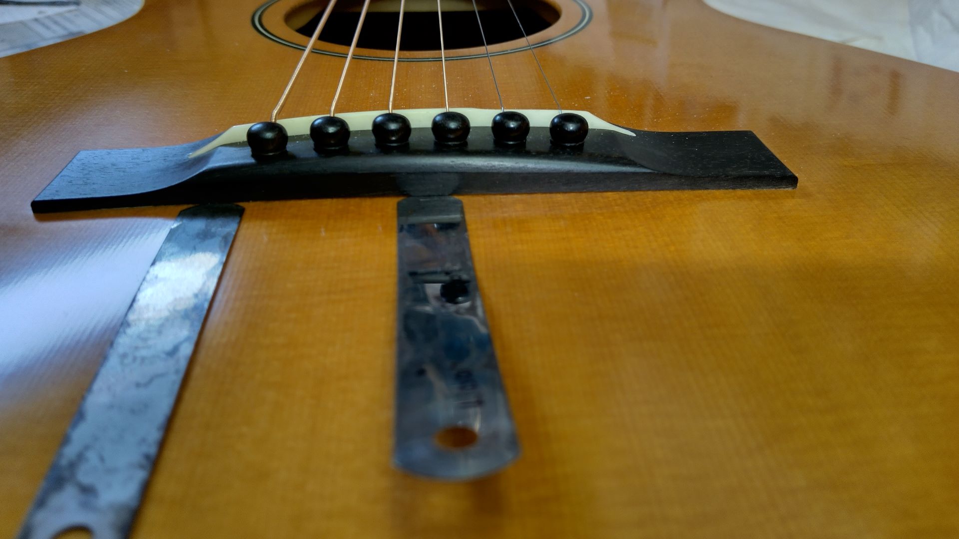

Prior to my purchase during a zoom meeting I had with Bob he measured the 6th string height at the 12th. fret and it was .122".  I've attached photos of the saddle/shim and gap at the center back of the bridge/top which is a max. of 007" to a depth of about 030". Also photos showing where the bridge first loses contact with the top to the left and right of the center. This is where the edge of a .002" feeler gauge first slips in.
