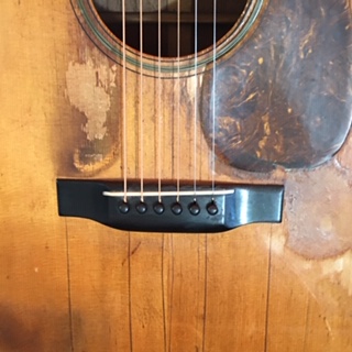

Paul, The diamond shaped cleats, used to close cracks, when properly done are tiny. I've had guitars crack & had them repaired with no noticeable sound difference. That's my non-scientific evaluation. Attached is a photo of a very fine sounding '37 D18 that I sat opposite of for a week in Flagstaff recently in the hands of Winfield winner Peter McLaughlin.

Greg Y wrote: Fri Jul 12, 2019 3:58 pm Paul, The diamond shaped cleats, used to close cracks, when properly done are tiny. I've had guitars crack & had them repaired with no noticeable sound difference. That's my non-scientific evaluation. Attached is a photo of a very fine sounding '37 D18 that I sat opposite of for a week in Flagstaff recently in the hands of Winfield winner Peter McLaughlin.IMG_8979.jpg
That makes sense given how many great guitars have been repaired. I just see how obsessed we seem to be on forums regarding tap toning etc. I always had this question and this seemed like a good place to throw it at the “wall.”
