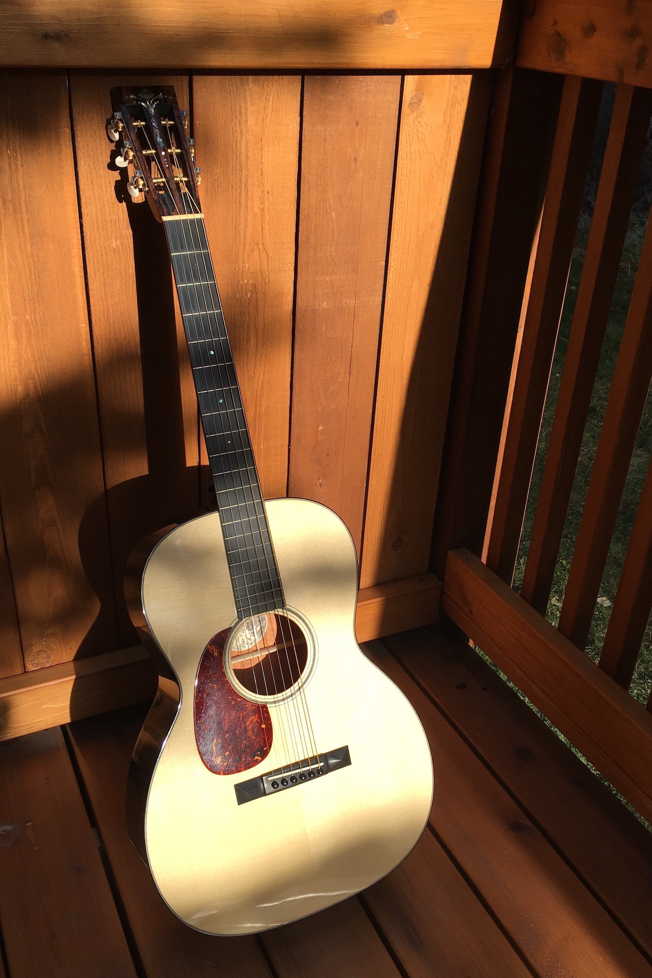

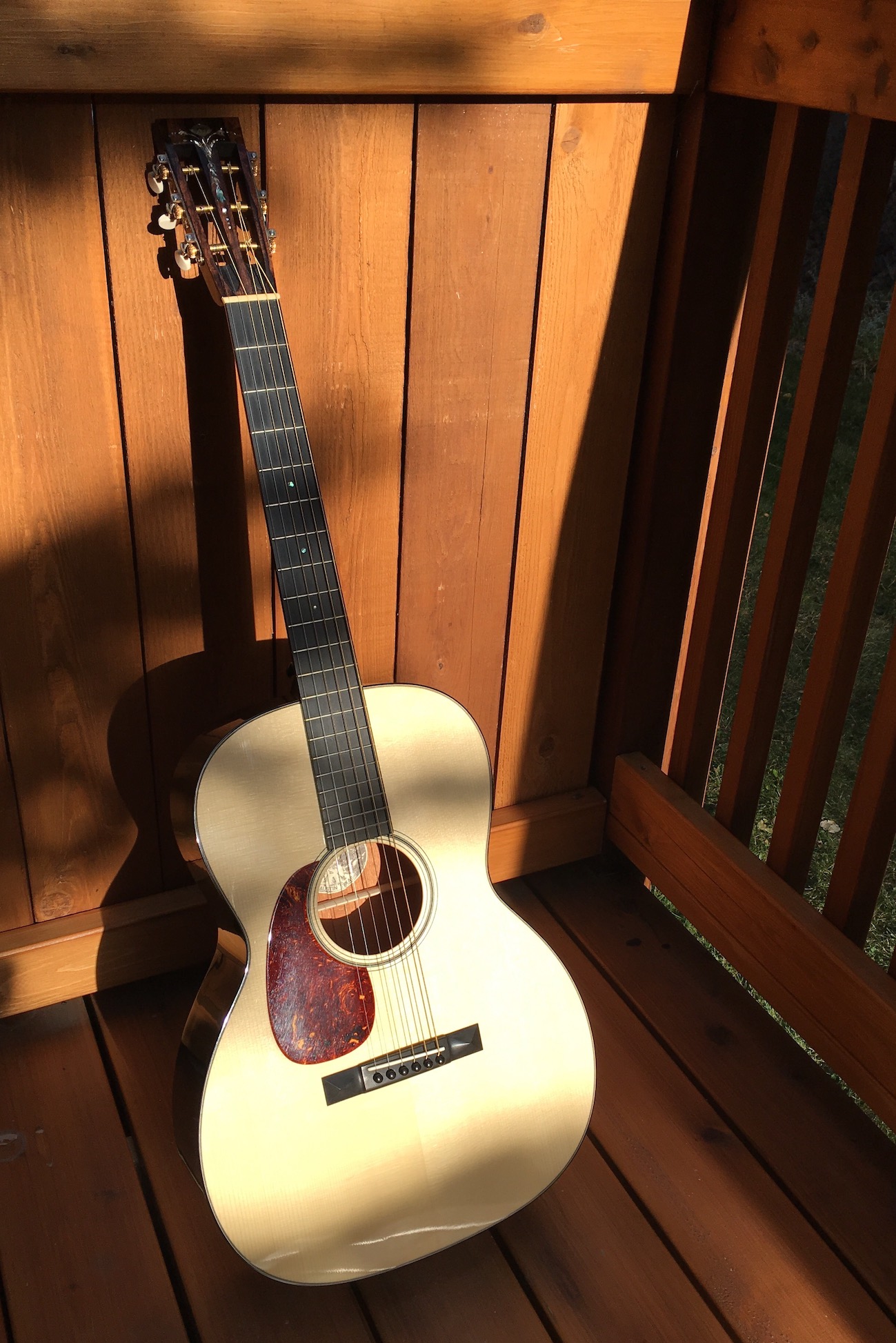

Thanks for the replies, fellas.
I got a new guitar with a pyramid bridge and am excited to get to know it. A Collings 01PecanE. 14-fret. New to me but looks like it just left the workshop.
This deviates from the bridge comments but I am pleasantly surprised by taking Engelmann through its paces. They sure know their craft.
And Frank, nice to interact with you again! It’s been too long.
Stuart
Stuart
