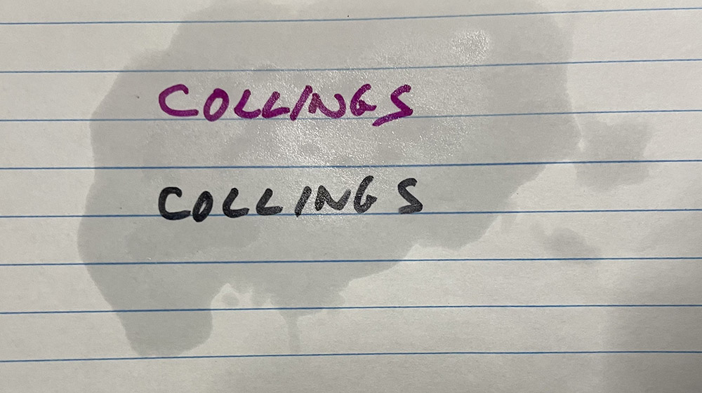

Being a chemist, I know what should work. Being a chemist, I also know it is better to confirm what you know before moving forward.
I took two Sharpies and then dabbed a generous amount of naphtha onto a standard piece of tablet paper. The lines on the paper did not run and neither did either of the Sharpie colors. While I do not know exactly what kind of marker Collings uses, it is my belief that most permanent markers will be fine for a short period of time with naphtha. DO NOT USE ANY OTHER SOLVENT as it will not turn out so well for anybody reading.
I would suggest getting a lint free cloth or cotton ball and get the label fairly wet but not sopping. It should come off fairly quickly and with no pulling. The naphtha should dissolve the adhesive quickly. Dry the label quickly in air so it has the solvent on it for the shortest time necessary to get it free.
